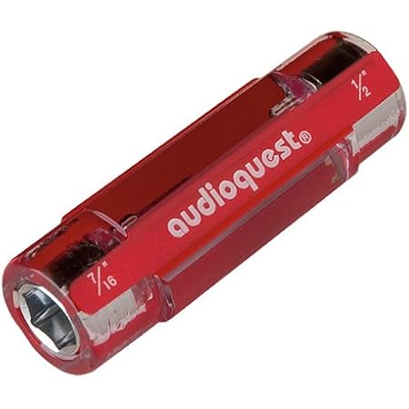

I agree, finger tight just doesn't cut it. Fir many years now I have used ab Audioquest device called The Postman. It look like a screwdriver handle with 1/2 and 7/16th sockets sunk into each hand. With an open ended or socket  wrench on a ratchet handle it is too easy to apply too much torque and strip or even break  a plastic binding post. The Postman gives you the grip of a socket but without the leverage of a wrench, making it easier to control how tight you make the binding post.
It does a great job and in audiophile terms it is a bargain at less than $20 from Amazon or any of the online high end dealers.
Highly recommended

I second Tom's post. I've also used one for a really long time and it is very easy to get a tight fit without overdoing it. Finger tight doesn't even come close to working: I found posts loosening up significantly over time with just finger pressure. The main reason I hate bananas, even the locking kind.
