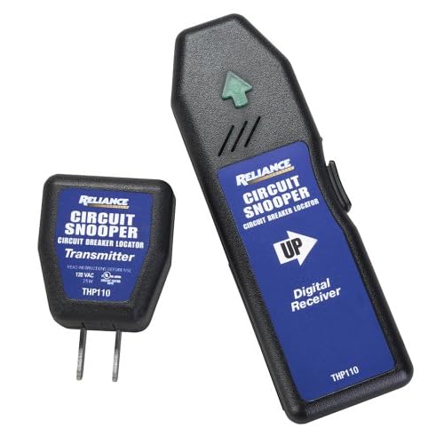

If the guy who initially installed the service didn't do it right the first time, I'm not sure I would trust him on the rebound. Circuit polarity is easy enough to check yourself and I for one would feel much safer if I eyeballed it personally. However, you do need to follow the safety rules. Most importantly, NEVER work on a hot circuit. Especially if you think it might be improperly wired. Kill the breaker before you even take off the outlet cover. If you don't know which breaker covers that out let you can use a digital circuit snooper.
http://www.amazon.com/Reliance-Controls-THP110-Digital-Circuit/dp/B000IF9KBC/ref=sr_1_10?ie=UTF8&s=hi&qid=1269011159&sr=1-10
You plug the smaller of the two pieces into the outlet and the other piece gets run over your breakers and finds the proper breaker by detecting the tone being sent by the other piece. (Some units require you to make multiple passes over the breakers to zero in on the right one - be sure to read the instruction for your specific model.). Once you find and open the breaker, recheck the outlet with the receptacle tester before proceeding to make sure the circuit is actually dead - belt and suspenders.
Once you remove the outlet cover and pull out the receptacle make sure that the wiring is connected in the proper places. On standard polarized replicable the hot lead (the black wire) should be connected to either the push in connection on the side of the smaller of the two blade slots or to the darker (usually brass) of the connection screws. The neutral (white wire) is connected to the push in by the large blade slot of under the lighter colored screw (usually silver). The ground connection (either a bare copper or green insulated one) is connected to the green screw. (see illustration below)
So the connections should be black to brass, white to light and ground to green.  While you have the outlets out always take the opportunity to  tighten up all of the connections (push and pull on the screwless connections to make sure they are still tight and do a torque check on all the screws.Remount the outlet in the box, and replace the cover. When you have finished with all of the outlets, reset the breaker and check the outlets once more with the receptacle tester. If you still have a polarity flip even with all of the outlets on the legs visually verified than the miswiring is in the breaker box itself. The breaker box is not a place to be playing around if you don't know what you are doing. My suggestion is that if you needed to read these step by step instructions to check the outlets you would be much better off having an electrician check the breaker box for you.
