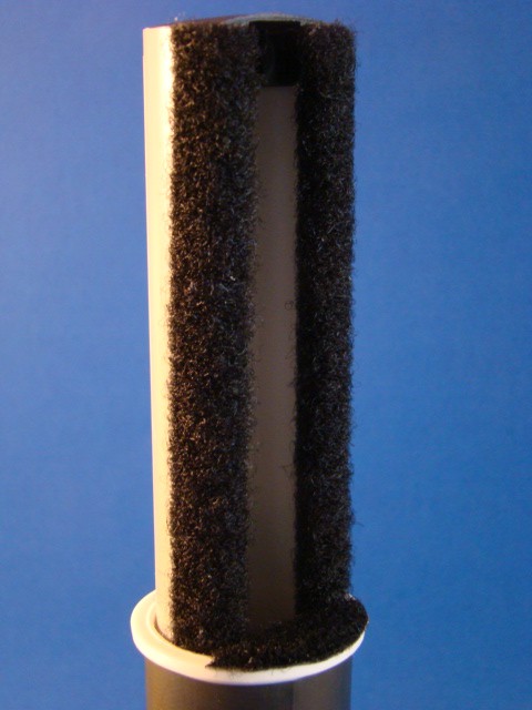

Are you still planning to reduce the suction of your vacuum with your record cleaner? The reason for my question is that I found that the reason why my Shop Vac can pull the record off of the platter. It is due to the width of the Vinyl Vac attachment. I believe membership here before informed me that the opening was just too wide to be effective. I got a different attachment where the opening is narrower and I can't pull the record off the platter any more.
Conrad Specialty Mfg Record Vac Cleaner Record Cleaner attachment
Just putting this out there as an FYI.
jimbones
I am using the VPI "wand" It has a very narrow slit. I made some progress this weekend I made a base and the fittings for the vacuum, pics to come.
